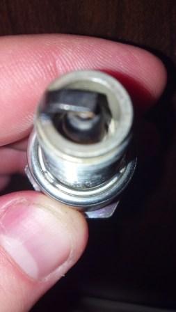

I just upgraded from stock reeds to Vforce 4's and, at the same time, I swapped my Toomey 2 into 1 w/ foam filter + outerwear for an aluminum air box (no lid) and a large K&N w/ outerwear.  The addition of the VF4's SHOULD equate to more airflow, right?  I figured, if anything, i would be running lean after adding the VF4's but, I think I am running rich now.   The air filter is nice and clean and the carbs are perfectly synced but it just seems/sounds a little rich, especially on the pilot jet. I don't have a way to do a proper plug chop right now but the plugs look pretty black, not wet but definitely black instead of the elusive cardboard brown color.  I also noticed that it wouldn't crank with the choke on like I used to have to do.   It cranks right up from being cold with no choke now.
Unfortunately, i don't know what size pilot is in it.  but the air screws were 3 turns out, which I believe is about the max you can go before you need to swap for a smaller jet, right?  I know the mains are 280's and I believe the needle jet is set on the 2nd position from the top (one away from the richest setting as I understand it).   I have T5 pipes, carbs are stock mikunis and the engine internals are bone stock with no port job etc, the rest of my mods are listed in my signature although I don't think anything else matters.  Elevation is ~800 feet and summer time temps here are between 75 - 90 degrees, although it was pretty cool and humid here today as we had some storms pass through - about 65 degrees if I had to guess
I'm mainly wondering if the addition of the airbox could have restricted the airflow that much more than the Toomey set up causing a rich condition even though I went from stock flappers to VF4's at the same time?    I have never jetted anything before but have been reading up on the topic quite a bit lately so I'm just wondering what people think before I start messing with anything.  I did order a set of 27.5 and 30 pilot jets on a whim not knowing what is in it now.
Not sure if you can tell much about the plugs

You are LEAN!
You need to get some #30 pilots in that thing before you burn it up.
Buy the way….that aluminum air box will bite you in the ass sooner or later. (FREE advice here….feel free to ignore it)  I'd just switch to K&N pods with Outerwear's. But you'll figure it out in you're own time.
Top clip is the LEANEST setting. (Lowering the clip RAISES the needle)
3 turns out on the airscrew is the LEANEST setting. (You always want to be between 1/2 turn out and 2 1/2 turns out.)

Well, good news is that I have some #30 pilots on hand here.  Why would my plugs be black if the bike is running lean?  I'm not doubting what you are saying, just trying to wrap my mind around all of this

WINDYCITYJOHN - I  just read back over some of the jetting information I have and it hit me, I thought I was running out of gas earlier and swapped it over to reserve to get home but that's a sign of running lean.  It never occurred to me at the time.  I guess I'll pull the pilots and put the 30's in there (I am thinking it has 27.5's now) and maybe I'll go ahead and drop the clip down to the middle notch on the needle while I'm at it and see how it runs from there.  I'll go ahead and order some different size pilots too.  I'm thinking that, since I have 280's, i'll get a size lower and a few sizes up just to have some extra options on hand.  Does that sound about right?
One thing I am unsure of here - Warming up the engine, then installing new plugs and hauling ass through all gears and cutting the engine @ WOT and cutting away the threads (plug chop) is just going to tell me the condition of my main jet, and not really reveal much about the others - is that correct?   If so, how exactly do i determine whether the pilot and needle are rich/lean/just right??

#1 - I can tell you what pilot you need in my sleep.
#2 - you have your needle and airscrew as lean as possible. So you are basically running on nothing but main. Your main might end up TOO rich once we add more fuel with pilot and needle. Or you might be pretty spot on with the main.
#3 - start with #30 pilot, needle in -3, airscrew 1 1/2 turns out.
